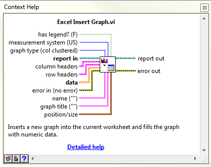

Hi wond3rboy,
You can use the Excel Insert Graph.vi in order to have the ability of changing the graph size.
