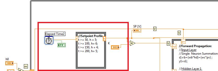

Apparently I have solve the problem myself. I used the elapse time express to change the setpoint at certain time using a formula node and add shift register to the whilw loop. And it work. What you send me is something similar and it does help. Thank you so much for helping! 🙂

This is how I solved it.
