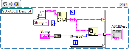

Hi Vaibhav,
use a lookup table with the U8 value of the char as pointer into the table.
You can create that "table" as 1D array of strings - which is much easier to create when using a usual text editor to create a txt file and reading the file using ReadSpreadsheetFile…

Hi GerdW and MC,
Thanks.
I found my complete table on the http://www.theasciicode.com.ar/ page.
