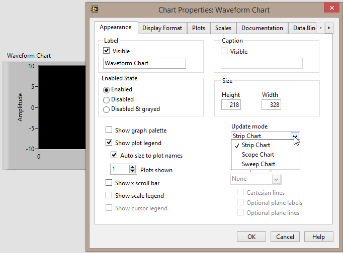

It's available for "Waveform Chart".  See help:
    • Update mode—Update mode of the chart. You also can use the Update Mode property to change the update mode of a chart programmatically.
