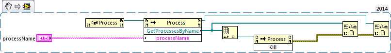

I got the Code (under this post) from another User and now I want to change the code so I can look that up. I thought that not switching off .net would be the best idea.

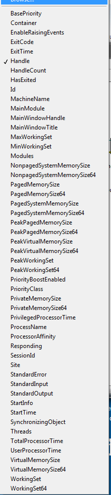

The Process reference has a lot of Properties that you can access. Maybe one of these can be analyzed to figure out if the process is 64bit or 32bit.
