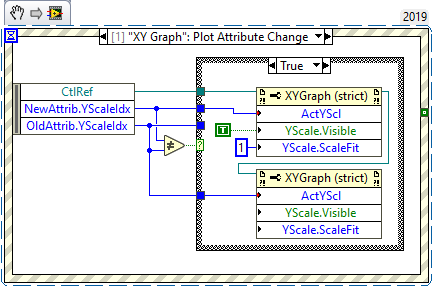

Displaying the second scale is not too difficult - I have an Event Structure which checks the "Plot Attribute Change" event and if New.YScaleIdx != Old.YScaleIndex, I make the New scale visible, and autoscale as necessary.

However, I'm not sure how I can check if the "old" scale has any remaining plots using it, and if not, hide it.
Is there some sensible method to do this?
I think it should be possible to iterate through the Active Plot -> YScaleIdx -> If Index == oldIdx, stop and return true, else, iterate, -> return false (are there any plots using this index scale), but
  • this seems a bit circuitous
  • I'm not sure how to generically find the number of plots in the graph
    • the graph VI has this information from the array size of the value
    • I could check this via the Value property node but it could lead to a copy of a lot of data for a poor reason imo if there's an alternative
    • I can also get the number of plots by autoscaling the legend (I'm already doing this, when I have legend values specified) and checking the Number of Rows, but I'm not sure I can force this to remain in sync with the number of plots (although that can't change - maybe the legend size could be altered leading to invalid number of plots if I assume they're the same).
How should I solve this?
