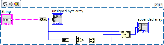

convert to U16 , sum, split number, add to array    and finally convert to string and send to VISA 🙂

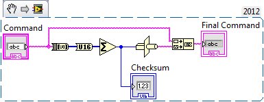

Meanwhile, I came to this solution.
As with your solution, I still get: "START  ®" But we are close. Smiley Wink
The correct output should be this string: "START 01AE". Any idea how to prevent conversion checksum from HEX to ASCII at Concatenate Strings?

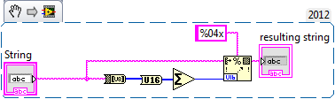

Using the format into string 🙂
Greetings from Germany
Henrik
LV since v3.1
Message 6 of 9
(6,620 Views)
Great, you are really fast. Thanks a lot! Smiley Happy Last think is Use minimum field width (for checksum part) with 4 characters pad with zeros on left.

You have been to fast 😉 I had edited my solution
