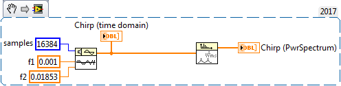

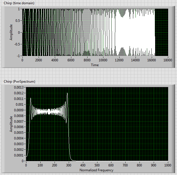

It works fine for me. So unless you post your VI (not a picture of your results), there's not much I can do for you.

My guess is you are seeing the results of a windowing function applied before the PSD which is a Hanning by default if you are using the waveform version of the PSD.

Now I also got the result. Thanks a lot. Also can you tell me why chirp spectrum behaves like this. I mean why starting and ending frequencies have somewhat more amplitude. Isn't it supposed to increase from start to end.

It is because the signal is finite and does not repeat. There are discontinuities on both sides of the time signal which causes rippling in the frequency domain. It's not just the ends that are effect, the whole range has some small ripple. The only was around is to window the time domain function to make it continuous, but then the steps in the frequency domain won't be as steep. You have to pick your battles. Wikipedia explains it farely well.
