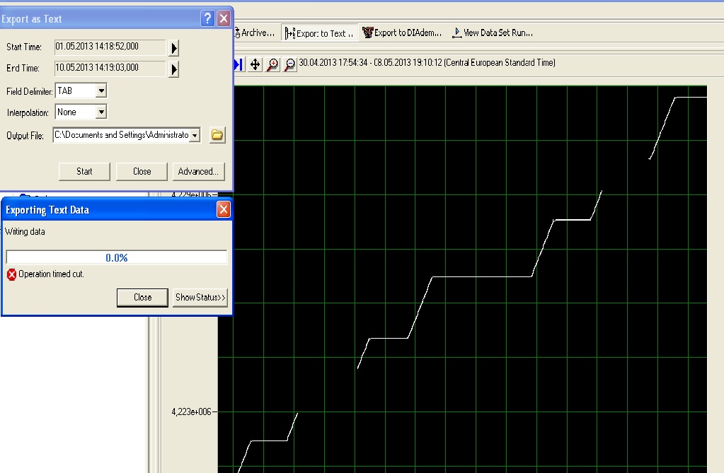

I have very strange problem which I cannot solve. I have taken database which have been logging data for 2 years ( Citadel 5) and tryed making statistical analysis with it. Problem occurs when trying reading traces in areas with data breaks ( data breaks occurred because of radio communication which have been breaking on times). When trying read traces in LabView 7.1 read trace goes to timeout and returns data with 0 elements. In MAX 3.1 when trying to export same portion of data with export to text same things happen:
Now, i thought first that database is corrupt or inaccessable however when i tryed doing same thing with LabView 2010 on same database (c/p) everything worked. My question would be:
1. Why is this happening?
2. Is there a way to fix it ?
Program works without problem when transfered to labview 2010. Database was created with tag engine in LabView 7.1.
Thanks in advance
