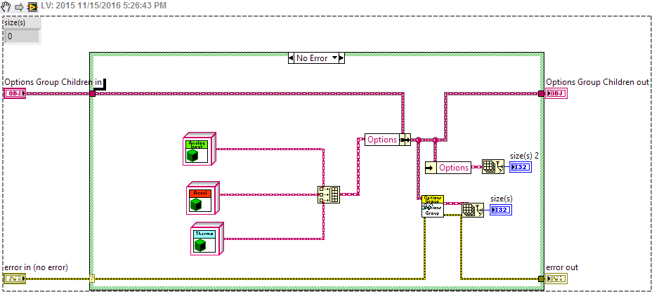

When I unbundle the the object I get an array size of 3.
When I use the data accessor I get an array size of 0.
Any ideas on what is going on?

Error in?
edit:  not likely now that I am off my phone.  I would check the accessor for funny business
(3,819 Views)
Accepted by topic author ASTDan
Had the data in the parent and the child.  Oops.
Removed the child data and everything is fine.
