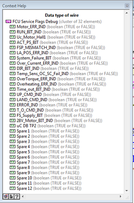

this cluster when used on a property in the program that uses that class has an old configuration
How do I Align them?

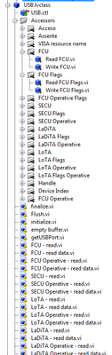

the Data Structure  *.ctl is Different from the accessor
https://zone.ni.com/reference/en-XX/help/371361R-01/lvdialog/create_accessor_db/
accessors define the final Name of the property and i expected the name to Update automatically but it does this only on creation of the accessor
after you need to keep the accessor Up to date to have the same name on the property
i guess is the same on other languages that use properties, my Fault 😓
(1,197 Views)
and Read should be coherent with Write if not the Class is Broken
