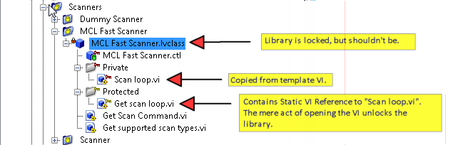

I've run into some particularly weird behavior of LabVIEW 2011 SP1:
  • I have a base class, "Scanner". Child classes will generally have a member VI called "Scan loop.vi", so Scanner has a member method "Scan loop template.vi". This template can be used to make creating a child class easier.
  • I created a child class, "MCL Fast Scanner". I copied the "Scanner : Scan loop template" member VI, and added it to "MCL Fast Scanner", renamed as "MCL Fast Scanner : Scan loop.vi".
  • Now, for some strange reason, when I open the project, the "MCL Fast Scanner.lvclass" library appears locked, with LabVIEW indicating that "this LabVIEW class is loaded in multiple application instances". I'm pretty sure it isn't (note: I'm note using any real-time targets).
  • I found a way to unlock the library: simply open "MCL Fast Scanner : Get scan loop.vi", which happens to contain a Static VI Reference to "MCL Fast Scanner : Scan loop.vi". Opening this VI mysteriously makes the library lock disappear.
I've tried to summarize this in the picture below:
So I'm not entirely sure what's causing this behavior:
  1. Either it's because I originally messed around with copying this template VI from the base class. This would seem similar to a post from a few years ago, mentioning an eerily similar issue. However, I afterwards tried re-creating "Scan loop.vi" from scratch, and that didn't solve anything.
  2. There's something strange going on with the Static VI Reference.
  3. I created the "MCL Fast Scanner" child class using the LVOOP Assistant; could that have botched something?
Feel free to contact me if the actual files are needed for further investigation.
Thanks!

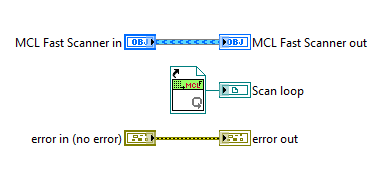

Could you please post an image of the code containing th static reference?

Sure 🙂 It's nothing special:
Note that I've used similar code for years all over the place, but this is the first time I've encountered this issue.

Hello onnodb,
I do not have explanations for such a behaviour at the moment.
Perhaps you can post the actual project in order for me to reproduce the issue and see what is going on?
Thanks!

This behaviour is actually caused by the auto-populating folder feature. If you put that feature off, the library does not appear locked anymore.
The issue has been reported to the developpers and should be corrected in a further revision.
@ Onno: I just sum up here our discussion to make this post complete, nothing new for you.
Cédric | NI Belgium

Hey,
Actually, there are more than one CAR related to the auto populating feature opened at the moment 🙂
Ealier in the development of his project, Onno ran into some corruption of his project (for reasons only him can give you). He thought he had resolved -most of- them. Thus, the locked library issue he still have at the moment is probably a consequence of a previous corruption. Because of that, I cannot give you a precise CAR reference, but for sure, the R&D is aware of some issue with the auto-populating folder. This one (CAR#347498) is probably intersting to follow though.
Cédric | NI Belgium
