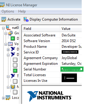

@crossrulz wrote:
A VLA has a license number.  You should talk to your administrator for it.  Or, if you are the administrator, take a look at the packaging your Developer Suite disks come in.  There should be a license number written down somewhere.
OR:  Menu>>Help>>About LabVIEW from ant FP, BD, LLB explorer, Project Explorer or Getting Started Window. (any LabVIEW window with a menu.... Kudos to anyone who can find an exception that is default LabVIEW behavior)
The current License is displayed in the About.vi
The Exception is if you switch from a single seat to a VLA.  Then the single seat key will still display in "About.vi" but the NI License Manager will show the correct key.
Message 8 of 13
