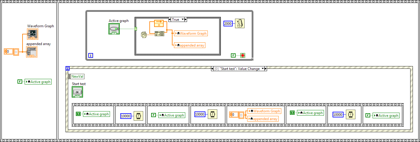

This both answers your question and, I hope, shows you a couple of better techniques for your G code. The "Start test" Boolean shown below is now a regular buttonButton on the panel, so it has proper reset behavior when read. The event structure means you don't have to sit there and poll the Boolean. Even if you're programmatically triggering this, the event structure is a better choice for performance because it eliminates polling.
I haven't changed the core of your test. I don't know enough about what you're testing. I will say that all of this work with local variables makes me *really* nervous. Those are my tools of last resort, so I only employ them if there is absolutely nothing else that will work. Be careful with them... it is easy to kill the performance of LabVIEW and/or get yourself into some nasty race conditions by using local variables too much.

I understood but in this case i can't use shift register.
Just to carify, one loop is used to control some features of the second one. The attached vi os just a small part with the question that I would like to solve but the program is quite bigger. It has some non stop loops that works the parallel to collect information fro diferente machines. However what I need is using an array calculate an average and get that actions evry time that I need but always that I use the array I can't clear for the next cicles.

The first loop is always running to collect data from a device. I'm simulating that using a random number generator. The second loop is also a simulation also that I made just to explain my doubt. The sequence is to gathering some data from the first loop during a while. All collected data is storage into an array. After that I need to stop collecting data to the array because i need to make some calculations with that colected data. This part is not simulated here but is not relevant to this issue. I just use a waiting time to simulate that Im make something during that time. Finally I need to restar to collect data again but I must to clean the array before however after the ceanimg action when I try to store new values I got all data history again.
