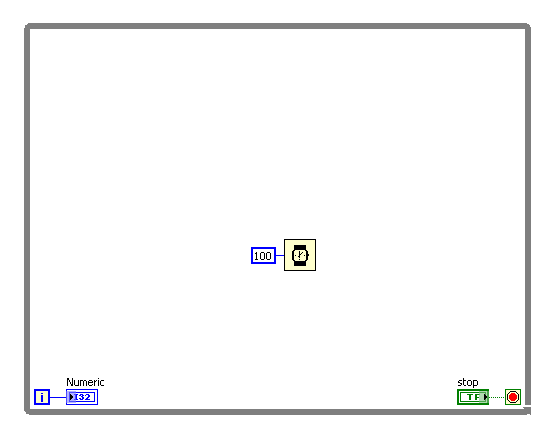

attached png of a "highly complex" piece of code to illustrate the problemSmiley Happy

When I run it, execution does not stop but the update of the screen does pause. In other words, I click and hold the title bar and the iteration count display does pause but when it does update, it resumes at a higher count so the execution does seem to continue.

That is also what I experience - thank you for making my post more precisely..
However - if you run this program with a real time DAQ and the buffer is only say 200 ms large, you will experience a buffer overrun, so I'm wondering where and when the execution is performed... It could actually be that the loop chokes on having to do x amount of iterations in a very short time, and thus also x amounts of screen updates.. I will try and make a temp DAQ program that has not front panels at all... This does not solve the problem as I still need to have the DAQ running in the same program that does the math and displays the results (yes, they are not in the same while loop) , but it could maybe help to clarify the origin of this "issue" - I'll post my results on that later.
