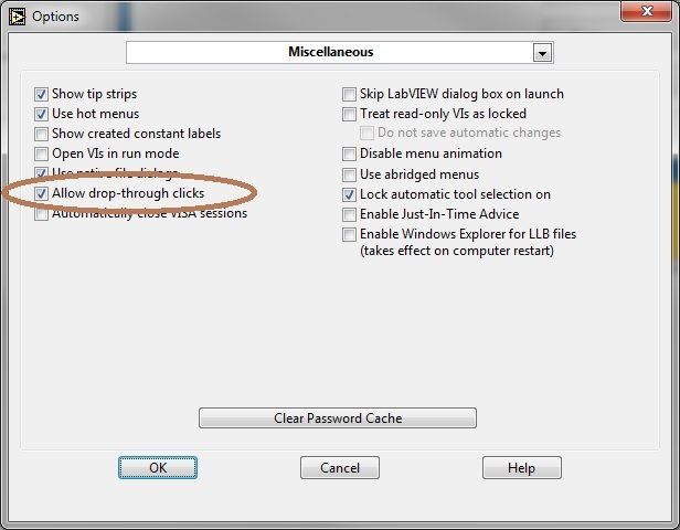

I think it was this one:Untitled.jpg
dropThroughClicks = TURE

I added "dropThroughClicks=True" to my labview.ini file, but it didn't change the behavior.
For me, this problem only occurs in Windows 10 (confirmed on two different computers).  The issue does not occur in Windows 7.
