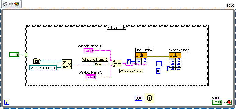

I am trying close NI OPC Servers programmatically through LabVIEW. When I open NI OPC Servers and any client doesn't start the communication I don't have any problem. However, if some client has started the communication although the client finish the communication and accordingly there isn't any process running, the program doesn't respond to my closing petition through LabVIEW. Anyone know any other manner of closing Windows applications? Maybe something LabVIEW program that works like close a process or program through Windows task manager?
In the VI you can see how you must write the path of your .opf, that is becouse of the window refered to the NI OPC Servers take a name that include the path of the .opf that is running in the NI OPC Servers.
