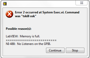

I would like to close the On Screen Keyboard programmatically, When i run "task kill" i get an error message as shown. How can i do this??

How do you format the taskkill command?
The command format is "taskkill /im <process Name> /f". You need to have admin rights to perform this.

Hey Anand
It doesnt close the osk. Works on other programs.Smiley Mad

So you always get the same error? I have windows 7 and have admin rights, it worked without an issue. What is your OS?
Also did you check the error in Terminal for the system exec.vi?

Windows 7 only. How do i enter in admin mode using command prompt itself.

I am afraid you cannot do that. Even if you are not in the admin mode you will not get the error, you would get a standard error from the "Standard error" output. Clear the error before the "System exec.vi" and then execute and also check the Standard error and other output.

I am aware that standard error output terminal. It says "access is denied". Thats why asked how to enter admin mode to execute the same

Hey All,
Any inputs on how to enter admin mode in command prompt using system exec.

Hi Shaper,
No clues about it using command prompt using system exec BUT
after building your app, you can modify your application access level by modifing the manifest file.
I bet these links can help you for that ;
https://www.ni.com/docs/en-US/bundle/labview-api-ref/page/resource/framework/providers/builds/appbui...
https://www.ni.com/docs/en-US/bundle/labview/page/working-with-the-application-manifest.html
