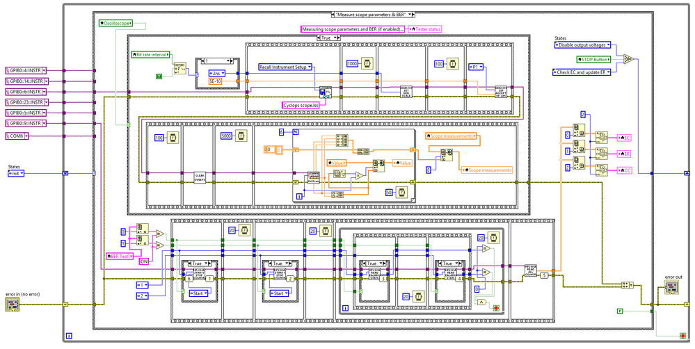

You can see below a screenshot of the state where the VIs which generate the error message are located (sequence on the bottom):
I have placed 6 probes and set the stop condition to "error" to capture the error as soon as it happens (the VIs attached to my first message are the ones placed before the probes 3 and 4).

Working from home on my (not huge) laptop, I can't see any detail in your picture, so I can't make any further suggestions without seeing the actual VIs.
