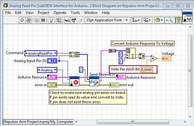

In the acclerometer output waveform graph, the x-axis stand for time in milliseconds and the y-axis stands for amplitude. So what does the units for this mean whether should I take them as in G's or in m/sec^2 as sometimes the values start from 2 and reach til 150 in y-axis.
(5,811 Views)
If you drill into the Analog Read Pin VI, you find that there is a "Send Receive" VI. The comments say that after the processing done, you read in volts. The MMA7361L datasheet says that the sensitivity is software selectable, either 800 mV/g (if you select 1.5g) or 206 mV/g (if you select 6g). If your sensitivity is 800 mV/g and your voltage is 150 V, your acceleration would be 150 V / (0.8V/g) = 187.5 g. Obviously the y axis value isn’t scaled.
Volts Read [V] / Sensitivity [V/g] = Acceleration [g]
What I’d recommend is to read in a known voltage, like a battery. If the voltage is not what you’re expecting, try to modify the “Volts Per AtoD Bit” constant so get the value you expect. After that, you can make the voltage to acceleration conversion like I described above.
