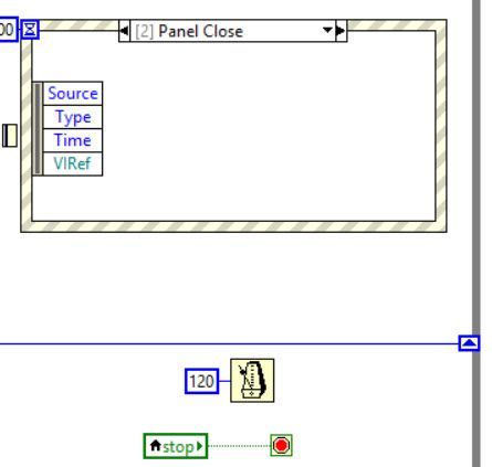

I have been reading in the forum and on the web however I seam not to get how to close the Front panel with an event ,I have the similar issue when my executable runs and the user press the stop button the Vi stops however the Front panel stay on screen and just change to the normal Front panel with all buttons and menu's similar to the one in the editor.I have seen various ways here in the forum to close the panel but fail to understand how to correctly setup an event .

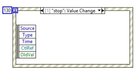

I have placed a event structure in the main loop with a time out(to avoid the event wait for ever and block the main loop) I the set up the Stop button change value event and a Panel close event .
do I need to place any code in here ?as my stop button state is read from a local variable in the main loop and the 2 parallel loops.
What should I do inside the panel close event to close the panel ? (the shift regeister in the picture is for the state machine states)

You should not use the plain "panel close" event, only the "panel close?" filtering event, discard it, and do whatever needs to be done before the VI closes itself.
Do you need to run special shutdown code if the panel close is attempted (confirmation dialog, hardware shutdown in the correct order, write a log entry, etc.).
What's the point of the local stop variable? That's not good architecture and can cause a race condition. Can you show is the entire code?
