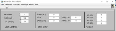

Hi All,
I am having an issue when my executable start it is running fine when the stop button is pressed then the Vi stop however it seam like the debug page that opens ,I have checked under build specification >> advanced that the Allow debugging is not checked and also in the Vi Properties I have now unchecked allow debugging,
How can I close the Front Panel when the stopped button is pressed ( I know it is preferred to use the X as in widows  however on my level the button is fine for now )
Normal Running VI(App)
Stopped Vi(App)
All help pointer and critics are appreciated
