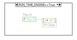

Update:
I think this should be the right way to do:
1) Drop VI Server Reference,  which should default to This VI
2) Call FP.Close to close the front panel
3) Use Conditional Disable structure to only run this at runtime.
Message 14 of 14
