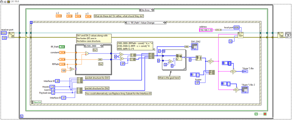

When the OK button is clicked, I want to pass 2 data namely DA1 and DA2 along with their respective packet structure(everything is available in the vi). While verifying the sent data through Wireshark, I want the DA1 data to be displayed post which DA2 data needs to be displayed i.e one after the other and not like a single shot of data and send it via UDP protocol. I am attaching my vi here. Kindly requesting your expert advice to accomplish the same. Thank you in advance.

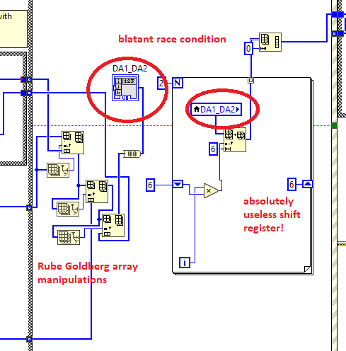

Your problem is much deeper thought and I would recommend to clean up your VI because there is a lot of unnecessary, wrong, and overly complicated code constructs that make no sense.
Here's just a small glimpse:
And why do you need a timeout event? Just to poll the logout button to close the panel while keeping the VI running? Most of your local variables are not needed.
You have a very simple problem: form two messages and send them via UDP. Should be possible with 10% of the code! Start with some basic tutorials.

Here's a tidied version that should be almost exactly equivalent.
It might be easier to work from this version if you agree it is the same.
The attached VI is backsaved to 2014 (seemed to be the source version).
The snippet is saved with 2019 so incompatible.
I'm pretty confused about the intention with the For loop - perhaps this is intended to be used to send separate packets?
In which case you might (instead of placing them all in one array) create two separate arrays of your headers + data blocks (DA1 and DA2 as two separate array structures) then call UDP Write twice as was described.

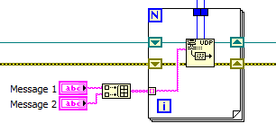

To send two different messages you can use two instances ot UDP send, or just use a FOR loop:
