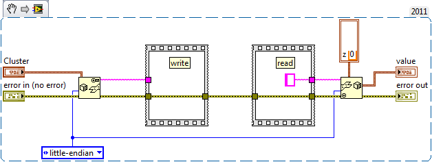

You want to do something like this:
Since your server application is a Windows app, it's likely that it transmits the binary data in little-endian format, but you need to make sure. The PIPE_COMMAND_EXAMPLE must be a C define that maps to a number! You have to search in the description what number that is and insert them in the ring control accordingly. The protocol expects the number as binary formatted number, not a string.
In LabVIEW Strings are so far simply a byte array but the controls have special features to display that byte array in different formats. Strings were the common way to represent stream interfaces, independent if they represent ASCII or binary data. This is most likely going to change in future versions of LabVIEW as Strings are at some point going to support Unicode and then a Character is not equal to a Byte anymore. But for now you need to live with what is there and the OpenG Pipe VIs were created over 10 years ago using the same principles as used through VISA, File IO and similar functions in LabVIEW, which also use Strings for binary data.
