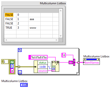

Fairly easy to go from an array of cluster to a 2D array of strings

yes, agree. but could you please tell me how to make it dynamic so it grows when I add new elements? And I couldn't find how to make a slider to scroll it.

Its an array of cluster not a Table. Just add elements to the cluster Horizontally and set the Auto sizing to "Size to fit". Pull an empty array from the FP control palette, grab the cluster and drag it to the array. Go to Visible item of the array and un-select the Index option and enable the Vertical scrollbar. You are good to go.
