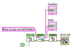

I'm commited to make it work despite of my huge ignorance on this subject. Actually, now I'm headed in the direction you mention using the HTTPVIEWHTTPClient.lvlib.vi library in LabVIEW 2014 SP1.
However I haven't been able to sucessfully get a valid response from a public test server for CoAP.
First of all, I have to mention that CoAP is UDP based, not TCP. I'm wondering if those libraries can be used...
However, here it is my setup:
Using the URL coap://coap.me:5683/hello it should return "world" (I have tested this with Copper (Cu), an add-on for Firefox which is a CoAP client). Instead, I get the LabVIEW error code 363524 that states that the protocol is not supported.
If instead, I fire the URL http://coap.me/hello, I get the response [:error, "Not Found"] which is okay, as that is the same response I get from any web browser. Using the same with the port 5683, I mean: http://coap.me:5683/hello it provides a 363500 LabVIEW error, that states it does not get response from the server, which is what I expected, the server is not configured to listen at that port http requests...

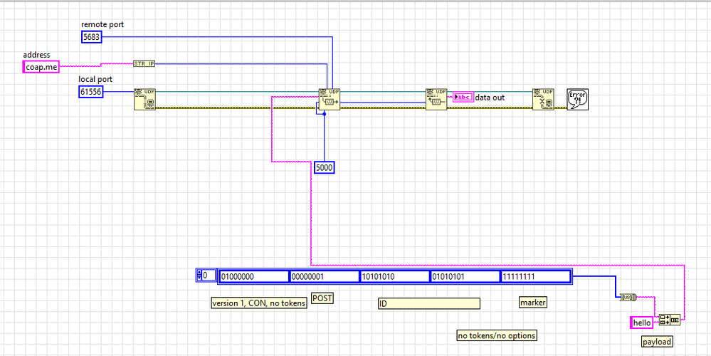

Just an update: I concluded that the way to go is to use the UDP palette.
Currently I have been able to get a valid response from the test server after I placed a basic "header" according to the protocol.
Now I'm building on top of that.
Later I'll share my findings about this in case anyone else is interested.

Yeah I was able to build it. Actually it was quite straight forward to write the client after reading the specification: http://tools.ietf.org/html/rfc7252
Altough I only implemented the parts that are useful in my case, which are quite basic and may not be a fully compliant one (ie. some Methods/Messages not implemented, No observer, etc), but it won't be that hard to add them. What I wasn't able to solve was the support of ipv6, as LabVIEW does not offer it, but it is ok in ipv4.
