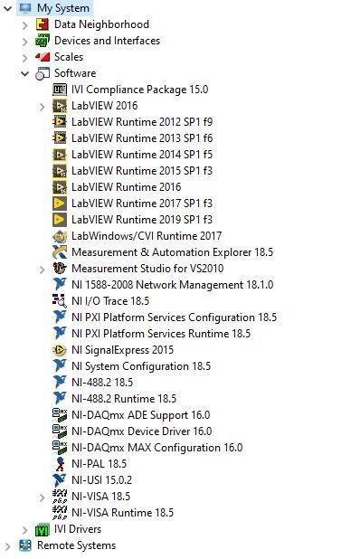

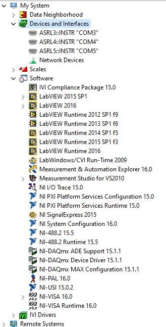

Developer PC config:
Target PC config:
Target PC confguration must be compatible with currently running application exe.
