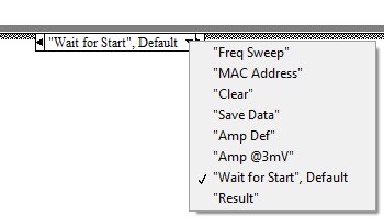

altenbach. I put the "wait for start" state in the timeout case which did the trick. Why is save "save data" the default when "wait for start" is set as default.

The default case means 'use this case if none of the case values match the selector value'. However, the value from the wire DOES match a case- the save case. The default value returned from an unwired node is a totally separate concept from the default case. The default value from the node is the 'zero value'. I assume SAVE is the first enumerated value in your enum.
