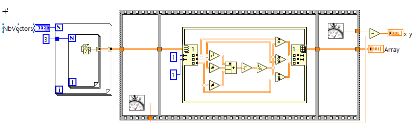

In the attachment, the algorithm that I searsh to improve.

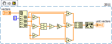

Hi Ubik,
what about getting rid of that loop and use polymorphism?
Which array size (number of vectors) do you want to process?
Message 4 of 8
(4,569 Views)

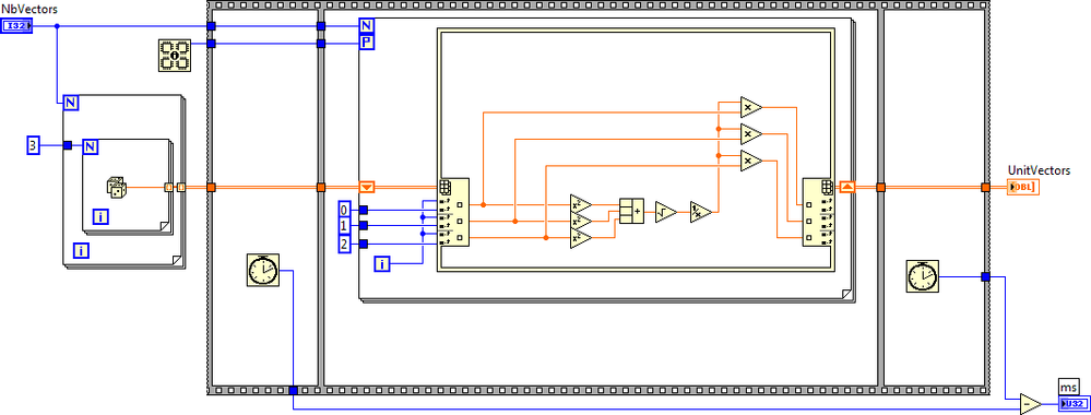

10 times faster for the In Place Element Structure into the parallelized loop. It's not suprising.
If I don't connect the P terminal, the performance is significantly degraded. I don't understand why, although I configured the loop parallelism on "Automatically partition iterations". I noted this behaviour many times, so I always connect the terminal.
Yes, loop-free without the IPE seems always much slower. Another slow solution is "unit vector" with the advantage of very simple code (it does much more, so it'll be slow).

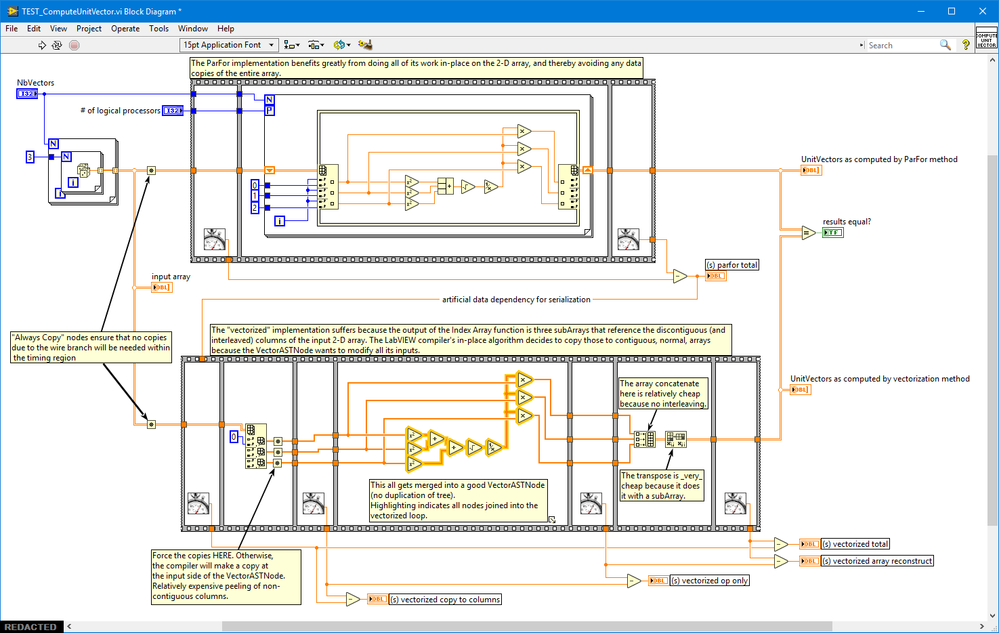

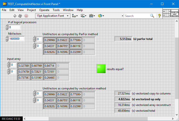

The performance discrepancy described here between the ParFor implementation and the "vectorized" (or "polymorphic primitive") implementation was brought to my attention and here is my explanation about what is going on:
TL;DR: the ParFor is faster because it manages to avoid copying the contents of the 2-D array. The vectorized implementation suffers from two copies: first stripping the columns out into three 1-D arrays (contiguous pieces of memory), then reconstructing the 2-D array after the vectorized operations.
Details: I hope the annotations on these pictures will suffice for the details. You will see in the vectorized implementation that I have made the first data copies explicit with the "Always Copy" primitives. Removing these primitives does not prevent the copies; LabVIEW will just put implicit copies just before the vectorized operations. I made them explicit in frame 2 so that I could measure the cost.
I also attached the VI (v 2018).
UnitVector- ParFor vs Vectorizer-BD (002).PNGUnitVector- ParFor vs Vectorizer-BD (002).PNG
UnitVector- ParFor vs Vectorizer - FP (002).PNGUnitVector- ParFor vs Vectorizer - FP (002).PNG
