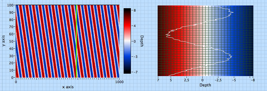

I have a set of data representing the thickness of a piece of metal, it's been measured at many points to make a grid of data and I plotted it using an Intensity Graph to show the topographical information. I then added a XY Graph beside it, and added a cursor to the intensity graph. As you move the cursor, it displays the profile at that slice.
I'm just wondering if it's possible to color my XY  graph the same way the intensity graph is colored? Would I need to have a plot for each region or is there a way to interpolate colors on an xy graph?

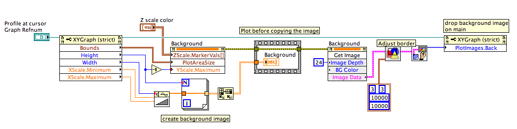

You can build a separate intensity graph with the appropriate colors, and drop the plot area image on the graph background, as shown on the attached vis

Improved version of the subvi below. Now the background colors matches exactly the Zscale.
Although the white color is not centered on zero, this is the correct result, corresponding to the imposed scale : white = 0.5.
I wonder why the Zscale on the intensity graph is shifted...

I think the Z scale on the intensity graph is shifted because I added random values to the sine wave to make it look a little noisy. I have it setting the mean value equal to white, so with the added random values it would probably be shifted up a bit.
