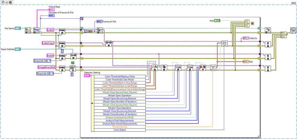

I have a pretty simple question: how to make the program work 🤔
Task: to detect the position of the rat in the video.
We tag animals with colored tags and look for these tags in the video.
I apply a very simplified program. There is only a search algorithm, without the rest of the program with a database and reports.
In general, the idea is this: process the frame with a threshold and then find the biggest spot.
But the problem is that sometimes the algorithm responds either to the cell or to the white walls. Especially if someone goes near the cage and the color balance changes.
Maybe we are doing something wrong? And do you need to pre-process the frame? Or after the threshold do something with him?
We apply a mask to speed up processing, as well as to reduce response errors, but this only helps partially.
In addition to the program, I am attaching a sample video to test the program. The video also contains color samples. One option is to use these samples as reference. But this also did not help, because sometimes the color balance in different parts of the frame changes in different ways.
Of course, some of the problems are created by a "smart" camera, which automatically corrects the white balance.
But we have already shot many hours of video, and this video needs to be processed, and manual tracing takes a very long time.
I would be grateful for any ideas on how to improve our algorithm.

The very first thing I'd do for any vision application related to color is convert to HSL\HSV, anything H.
The color, especially one plane (e.g. red) doesn't mean anything for the color!
Light green (0xA0 FF A0 for R G B) has more red in it than dark red (0x80 00 00).
Always use Hue for color detection. Now I can't run your code, and maybe the Hue is part of the magic inside those detection VIs. But I'd manually convert and get the Hue as an image, and do a plain (not local) thresholding on that image.

Yes, we use "H-magic" and yes, I know about color components

So the AVI is already converted HSL? Because all I see is a conversion to greyscale.
Ah, so that's in the color mode of the detector... It's a bit tricky without the ability to run.
I'd (also) convert to Hue, so I can see what's happening.
IIRC, White (and black) translate to pretty much arbitrary hues. So a limit on L would filter out whites (and blacks).
Note that there might not be a way to get all correct objects without incorrect ones... If these objects have specific shapes (or other relation) you can use that to narrow the selection.

It seems your solution has one H, S, L threshold. So each color needs to be in range of the H, S and L limits.
Have you tried to treat the colors individually? So get the reds with a HSL threshold, then the blue, then the green?
That seems to work OK-ish for me (although I used HSV).
The blue is a problem. The green color in the shade turns almost blue. So that's hard to distinguish.
For the red I had to merge two ranges. The Hue of red centers around 0 and wraps to the max, so one range doesn't suffice. You might need 190-255 and 0-15 or something like that.
