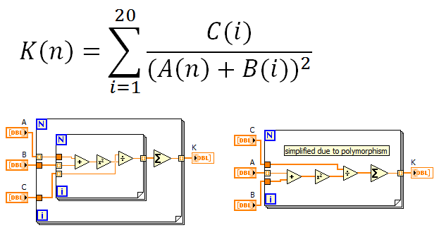

I have three arrays: A,B and C. Lets say (in a very simple case) each one has 20 elements (e.g A(1)=2, A(2)=8,...,C(20)=34). Now, the fourth array (called K) should be created by a combination of these A, B, and C. The first element of K should be obtained by sum of C(i)/((A(1)+B(i))^2 which i=1,2,3,...,20. The second element of K: K(2) is sum of C(i)/((A(2)+B(i))^2 and so... (just like attached)
I did my best to get this K array but it did not workSmiley SadCould any one please help me about this?

Hi Soran,
try this:
On the left you see the "literal" implementation, the right one is simplified using LabVIEW's polymorphism…
As it's quite easy I don't post a snippet or VI!
(2,755 Views)
Thank you Gerd. It worked.
