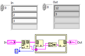

Your question is ambiguous because you don't even define the datatype of the array (numeric or string).
Assuming the simplest possibility, here's my solution. No need for any math:
Next time try to define the problem better. It would have helped tremendously if you would have attached a small VI containing typical data. Can you guarantee that all array elements contain single numeric digits? Can they be negative? If the first element is zero, do you want to display the leading zero in the result? Are hex digits allowed? So many unanswered questions!
