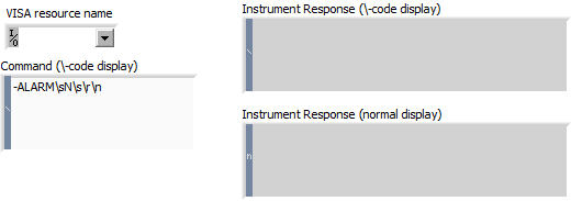

I doubt you have, else it would be working. Now you are attaching a VI that we've already seen, with all input fields blank. Enter what you think is correct into the control named "string" (I am sure there could be a better label name!), then "right-click...data operation...make current value default". Save and attach the VI once more. No we can see what you actually entered!
Your string is still in normal display. Have you tried changing it to \-codes instead?
What do you get if you run the attached code (after entering the correct resource, of course)

It worked after setting the string to code display, thanks a lot!
