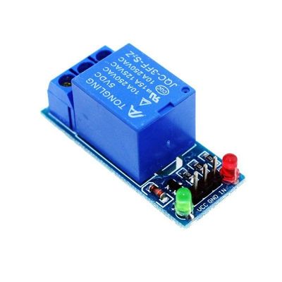

Assuming that you got a 1-channel arduino compatible 5V relay, like the one pictured below (contains a transistor to control the relay),
Connect the following pins of relay module to 6001 as follows,
VCC -> +5V
GND -> DGND
IN -> any Px.y (like P0.1, read as Port 0, Line 1)

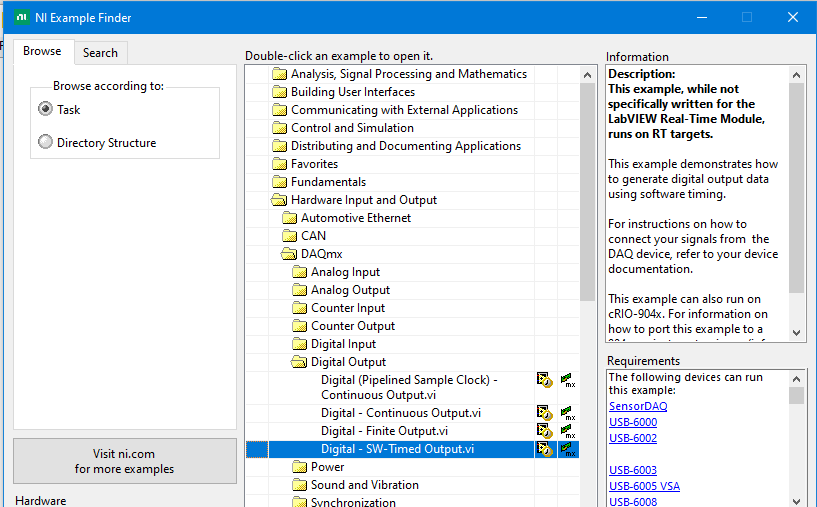

To control the relay, you can set the digital state of the Px.y using DAQmx APIs. Checkout the following example from Example finder.
