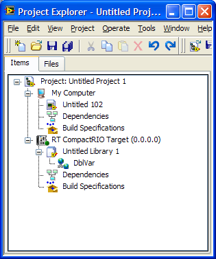

Nathand - In my setup both systems are hosting the variables in my setup and that is where the problem is stemming.  In order to use the same variables in different projects, the library has to be included in each project (from my understanding).  Therefore when a project is deployed to run, the corresponding VI that uses those variables starts the variable server on whatever machine-type it is running on (Windows, RTOS, etc...).  Then when the next project starts its own variable server with the same variables, but since there are two separate copies of the variables the data is never passed.  Unless there is some way to specify where to run the variable server and cause projects to not deploy that server but rather just access the one created, then the possibility of this working using shared variables increases.  Until there is a way presented to do that, I am not sure that is going to be a feasible solution.
You want the cRIO to host the shared variables, not the Windows systems.  That makes the cRIO the central source for your data, and both Windows projects can subscribe to that data without interfering with each other.  You do need the shared variable library in each project, but you can put it inside the cRIO target rather than inside My Computer as shown in this screenshot.
20157i3F2A5DBE3752EBD1
Message 8 of 14
(5,435 Views)
I have exactly what you have in the picture but the problem lies in my other project. I have a completely separate project that needs to use the same variables.  So in order to use those variables in that project I need to put that library in another VI, which causes both servers to start.  In essence I have two of the pictures you have above.
-You can never have too much power...
Message 9 of 14
(5,427 Views)
When you start the second project, are you re-deploying to the cRIO?  I would expect that if you run only the Windows VI in the second project, it will not re-deploy variables to the cRIO and will instead connect to the existing, running shared variable engine.  If that doesn't work, you could also try the "enable aliasing" option which should allow you to bind your shared variable to the PSP URL of a variable hosted on the cRIO.
