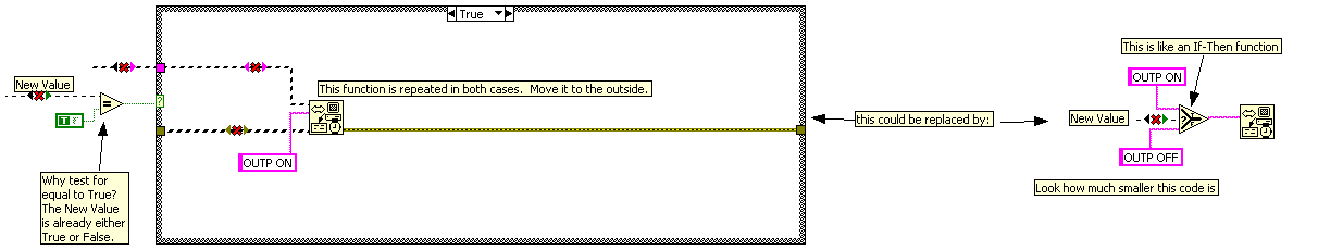

One thing you should really learn is how to use subvi's.  You don' thave to have every bit of your code in the main block diagram.  The size of the block diagram is just too big.  You can't see the wntire code without having to scroll all over the place.  The code in most of the event cases should be turned into a subvi.  Then just call that subvi inside that event.  This would shrink your block diagram tremendously and make it more readable.  It also would make it more maintainable.  It is called modular programming.
Here is a tip to make your code smaller:
20875i42F3C44DCA1B7DBA
