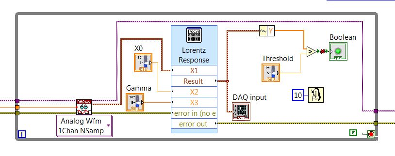

Thank you for feedback. Here is fragment of my VI.
The signal acquired from DAQ is then transformed inside of block "Lorentz Transform" (on the "Lorentz Transform" output the data is still waveform-type) and then should be compared with threshold.
When I transform wafeform in 1D array and apply it to comparator, discrepancy persists: array cannot be properly compared with single value - connection to LED is broken.
Does exist some example, where data is acquired by DAQ and then this stream of double values is compared with a threhold: when the acquired runtime value is greater then threshold, LED is ON.

Hi Pavel,
Your conclusion is: I cannot compare because I cannot display the result of the comparison?
You can compare an array to a scalar!
But you cannot display an array in a scalar boolean indicator!
Either use an array of booleans or a suitable boolean operation like "AND array elements" or "OR array elements"…
Your should check your wording: a waveform contains (usually) more than one value!
So you need to define, when the LED should be ON: when all values are above your limit or when atleast one value is above the limit?

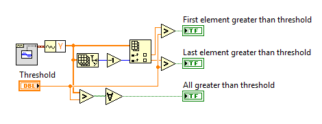

Like GerdW said, you have an array of values (multiple DBL values) that you are comparing to your threshold. You need to define the criteria that the LED will show True. Is it when all values are above threshold? When the first value is above? When the last value is above?
There are many possible ways to do this.
