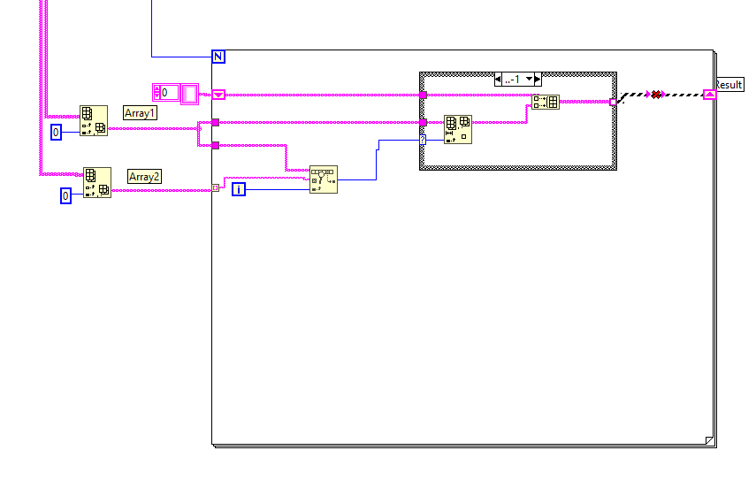

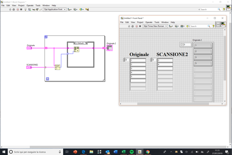

other the error on the right related to the size of the array I think there is more to do.

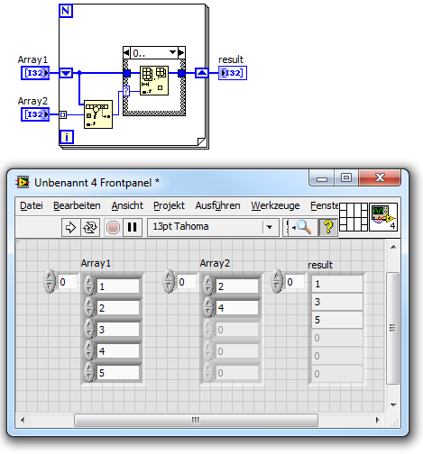

Hi Frank,
did I mention any BuildArray function before?
Just a shift register, Search1DArray and DeleteFromArray:

Because it does not work?
Message 9 of 14
(4,932 Views)
Attach your VI and not a picture.  We can't debug pictures.
I'm suspicious of 2 things:
1.  You are working with strings and not numbers.
2.  Both of your input arrays have what appear to be empty strings as the last element.  While I'm not sure how that would cause element "2" to appear, dealing with strings and empty strings certainly wasn't part of your original problem description.  Perhaps one of those "2" 's is not just a "2" but has a space or some other hidden character in it.  For example, if you are searching the array for "2{space}", it certainly will not find a match with "2".
