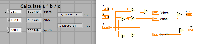

This a classic of numerical computation : the quality of the result depends on the operations order.
A simple example is the calculation of a *b / c   with a,b,c  equal to 25, 200 and 100 respectively. The result should be 50, but if a, b and c are U8, the result depends on the operation order, as illustrated in the example below. With DBL and non-integer data, the difference is of course much smaller, but still exists !
20071iC07C11C796139052
20073i9B08DAA0A6214317
In your case, the difference arises also from the order of operation :
- in the add array, the product of all elements is calculated first, and then the array elements are added.
- in the loop, the add is performed after each multiply.

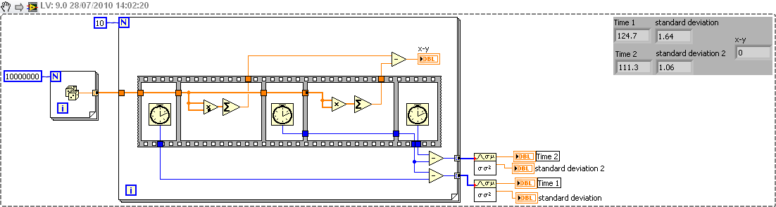

I have a timing question (Altenbach ?) :
With the attached vi, where I have suppressed the wires crossing the frames, the timing difference between add array and add-in-loop is much higher (x 2). Does this means that there is some overhead transferring data across frames ?
And there is no significant difference between BLAS and dot product.
Chilly Charly    (aka CC)
Interesting observation.
I take a wild guess: If you look at the buffer allocations, you see that now the buffer allocation for the second array occurs right at the sequence boundary. Could it be the allocation is now made before timing starts, falsifying the results?
(When the wires cross the frames as in the original example, the allocation occurs at the multiply node instead.)
Message 6 of 9
(4,732 Views)
Good catch. Buffer allocation is indeed different. But which is the falsified result ?
Edit : doing additional timing tests
Message 7 of 9
(4,722 Views)
I think the falsified result is the fast one, because it hides the cost of the buffer allocation. The size of the array is known at the time the FOR loop starts running, way before the first tick is taken.
There are additional potential flaws (but I don't think they make a real difference). In your version, some of the output subtractions can be calculated after e.g. the third and fourth frame of the sequence, and the corresponding indicators can be scheduled for updates. Since this is already happening while the later frames are still executing, they could potentially compete for CPU with the later frames, making them look slower than expected.
