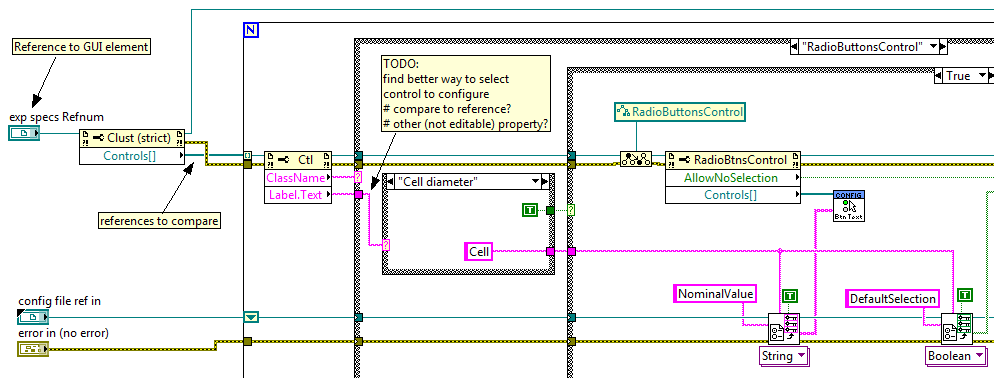

1) The user interface is configurable by a INI-file. To keep the main VI clean, a subVI takes a reference and makes the dirty job. For now I decided to keep the first implementation - which is to compare against the labels instead of the references. It's OK as long as nobody fiddles with the label texts.

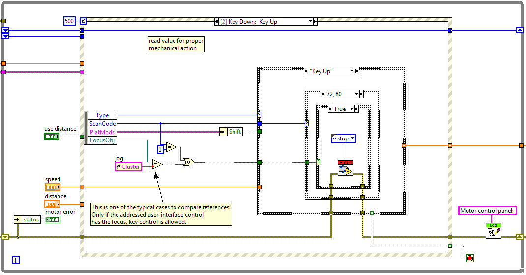

2) Enable key access if and only if the focus is on the addressed control:
This is the most critical part because the cluster is typedefed. FocusObj gives a reference of type GObject, so the cluster reference is downcasted before comparison. The code works, but it needs caution not to break it silently by accident.

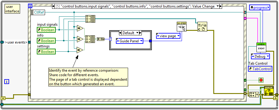

3) Share code in an event structure ...
Here a workaround is easy - just split into separated event cases for each control (this is an issue of code duplication which is just not pretty).
So the case 2) is the main issue. The most clean way would be the comparison against references - except for the few cases described earlier in this thread. Alternatively I could compare against the label in general but I would be glad for any suggestions to make it in a cleaner way.

That sounds like some darned good work!  great sleuthing and quite a bit of patience to get working code.  And you posted summaries with examples noting where the workarounds could break for future developers.
For workaround 1  Labels are not run-time writable so the caution to code maintainers to NOT fiddle with them seams suitable even if it causes developer constraints it wont risk deployed code.  Not ideal from a purist perspective but probably a good solution given the problem scope.  If the maintainer of the code can't read the comments.......
Same with Case 2.  caution the maintainer, make the code work, ship the solution, the user is not impacted so send the invoice and get paid!
At 3 the code smell is a bit ripe with the duplicated code.... Again, with the constraints you worked against I would pass it in any code review.
