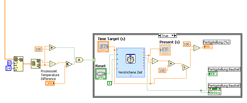

Hi Eduardo,
what about this:

Hi Gerd,
So, I actually did almost the same thing as you suggested, but I still have some questions.
- Since this is just a small part of my vi, I still have several other things going on, in the same part of the flat sequence structure that's encompassing the rest of the program. Should I have this entire part I just added, timer and the trigger for it (or just the trigger), inside of a new while loop, or is there something better/simpler?
- The temperatures, the values that are coming from the array, are going to be constantly changing, and it's crucial that the timer stay running, even if the condition of them not being more than 20 degrees from each other is not true anymore. How can I tip off a trigger like that, so that I just have to have these initial conditions be true once for the timer to start running? Should I put the timer in an event structure?

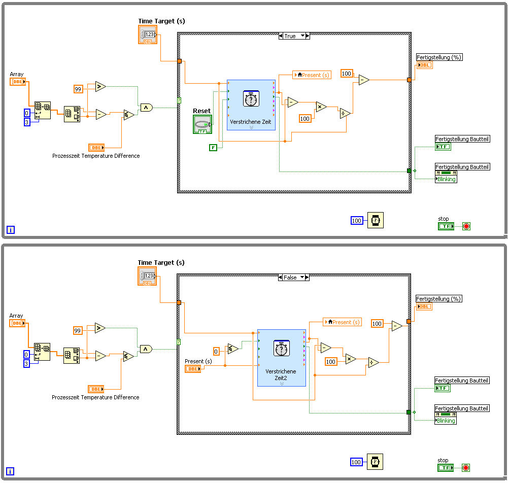

So I tried creating a separate VI, with just this timer and the two conditions. It will initially execute as it should, when the temperatures pass 100, and when they are within 20 degrees of each other. But, when I manually change one of those conditions to false, the case is no longer true, and the timer stops running, which it shouldn't.
Not sure I'm making myself clear, but like, the timer is not suppposed to run before those two conditions are true, and it should not stop running once they aren't true again. Not familiar with event structures though, so that's why I'm not sure I should be using that instead of a case structure.

Hi Eduardo,
You have to define your logic carefully! What happens the second time the conditions become true?
Get rid of the case structure:
The timer gets resetted when both conditions become TRUE (by help of rising edge detection), else the timer just runs up...
If you really insist on "timer is not suppposed to run before those two conditions are true" you have to include some more boolean functions like here:

(by the way, this is just a separate simulation I'm running from the actual program, so that's why the array and some other stuff is different)
There we go!
Just made it pick up from where it left off from in the False Case, and told it to not start (or just reset) if the present time was 0, which it would have been if the True Case had never been set off before.
Only real problem now is that the Present (s) doesn't reset to its default value of 0 after I press stop, but since this would only be fired up once, and then the program would be shut down, and restarted a different day, it won't be a problem. And a friendly warning to remember to write 0 on the control if they were to start it again would also go a long ways. All in all, I'm satisfied.
Thanks for the help!
