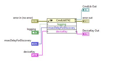

I am working with Labview and Newport Piezo actuator driver. It has library for controlling piezo actuators which works fine when I am working with non - compiled VI's.
There is a function which discovers connected piezo controller and it accepts an argument Delay for discovery. It means that it waits a certain ammount of time to discover the device and if it is exceeded - it returns an error that no devices were detected. By default this time is around 5secs.
When I am working with an uncompiled VI's, program waits for like 3s and connects successfully. However, when I compile it, it no longer waits (skips the wait time) and reports that no device is connected (but it is connected!).
I tried disabling build optimizations and other build settings, but without any success. I am using labview 2014 32bit version. But it also happened on 2013 LbView. Delay time is hardcoded as a constant, 5000 ms. I attach the image of device discovery function. I do not include the whole project, since it is quite large and a bit messy. Any ideas where the problem is?

Could you run you executable with the error out indicator visible in order to see if any error occurs?
You could also try to identify the dll which is used by the toolkit and put it inside the same folder that contains your executable.
Message 2 of 9
(7,882 Views)
You were right indeed - it turns out that labview skipped 2 other dll's (wrapper and ethernet configuration) which were needed for this function.
I was expecting an error in compiled program, but I guess it does not return them the way it does in VI's (without an indicator).
Thank you for your help, I have a functioning program now. It was a rookie mistake.
