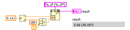

I don't think so, but you can always use a string indicator and do whatever you want with the parts. 😄
Or even do degrees. 😉
