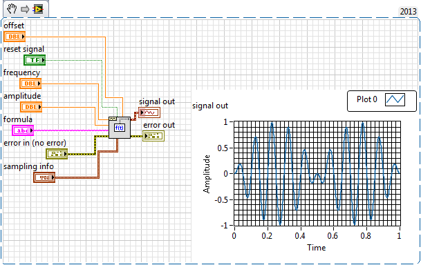

Hint:  Try looking in the LabVIEW palette called... WAVEFORM GENERATION. Smiley Wink

something like this:
Help

What was posted does that as you describe it.  You need to provide more details on why the posted solution doesn't meet your needs, or post more needs.  The solution does graph functions that a user enters into the controls.

Good Lord!  I even linked to the detailed contex help that clearly explains it graphs a user suplied function input into "formula"
Just the default value is "sin(w*t)*sin(2*pi(1)*10). " where: w=2*pi*f , f defaults to 100Hz and t is in seconds computed from Sample Info.Fs for each sample in the waveform.

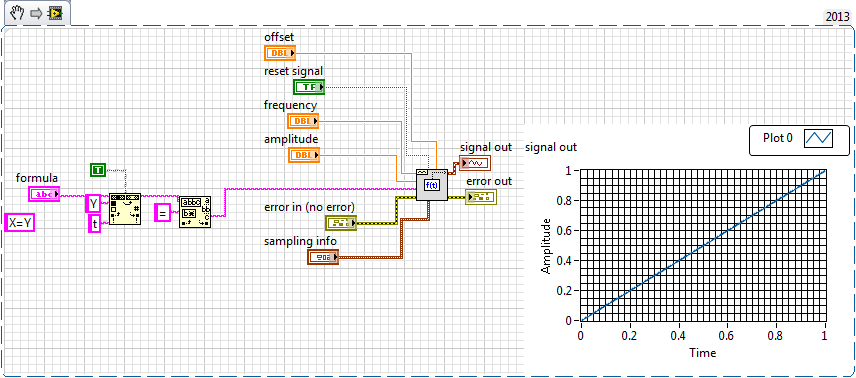

I want to generate a graph for a function but the given block diagram will generate waveform..
For e.g.. If user enter X=Y he should get line passing through origin having slope 1 i.e.. Angle=45'
like this I should get graph for any type of curve if I enter equation of that curve....
Message 9 of 13
(6,404 Views)
Oh like this?
Attached Saved for 2012
