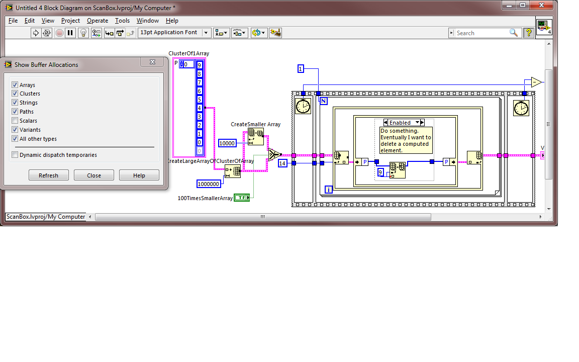

I'm trying to reduce computing time for large arrays. (In real life I'm eliminating unimportant vertexes of a 3D-mesh.)
Migrating from 8.6 to 2011 already has done a great job for me. And also I'm happy to run Windows 7 on a 64-Bit machine.
But, imagine a pointer orientated language where you would change one array element, you wouldn't expect the computing time to change with the actual length of said array.
Here I'm working actually on a large array of clusters of possibly different length array (rather short ones, containing the indexes of my vertex's neighbors).
My problem is that I really can't see the reason for (neither am I happy about) the 100 times slower performance when having a 100 times larger array at hand for just exchanging on elements value.
Any suggestions for work-arounds to get the speed of large arrays comparable to small ones is highly appreciated.
Kind regards
  Jannis
PS: I tried DataValueReferences but just the computing time to get 1Million references nears an hour.

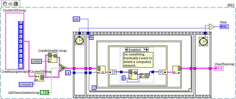

  I am far from the most experienced person when it comes to LabView performance analysis, but I thought I'd give a shot at replicating your sample code.  What caught my attention was the use of tunnels in the For Loop.  I'm really not sure how LabView handles the memory for these, but it apparently has an interesting interaction with the In-place Element Structure.  I tried replacing the array tunnels in the loop with Shift Registers and the performance different was enormous.  Not only did the entire process run faster, there was no significant difference between the larger and smaller input arrays.
  It's possible this isn't relevant to your end application outside of the sample code, but I thought I'd throw that out there for consideration.

try using Tool Profile >>> Show buffer allocations to get another clue.
I suspect the contruct used to develop the large array spits out a buffer but since the code want to modify it and the buffer should be the same for evry iteration, LV has to duplcate it.
If using a Shift register, you are telling LV it is OK to modify the buffer so the allocation happens only once.
But I am just throwing out ideas to try and help,
Ben

Hi Steven , hi Ben, thanks for your interest,
yes ist seems you're on to something there. Maybe I'm chasing a phantom here - as so often! Of course I'm using the "Show Buffer Allocation" a lot, but it seems I missed it this time. Looks like I have to change the way I do the bench marks. Cause, you can trust me, the real world application shows just this effect (otherwise I wouldn't be doing this) and I'm trying to home in on the "time hole".
I'll keep you posted once I checked the other "suspects".
Jannis

I'llesist the urge to recreate the code you posted, just to make it more fun.
I think what is bogus about your benchmark is
The buffer shown at the input of the inplace structure is telling you the entire buffer that is holding the output of the select T/F is copied to the input of the inplace for every itration of the for loop so you are really meassuirng that operation not he stuff inside (I think). The SR on the For loops elminate the copy.
Folding:
folding is a term used to descibe the process when LV finds code that is invariant, does not change, so it precompiles the answer rather than comupte it at runtime. Christian's comments above will rule out folding.
Please show us the real code with the buffers showing so we can help with the real issue and not a contrived issue.

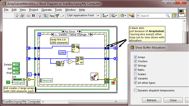

Steven and Ben have worked out were my bench mark test was badly set up, which Ben has perfectly explained. That test did send me on a phantom hunt expecting the time delay for large arrays at the wrong spot - the In-Place struct.
My next mistake was my local chaos with different LV-versions and 3 PCs: Altenbach and Jeff are of course right about keeping the array size constant and just marking the reduction in a separate counter. I did this at some point in a later lost version - and didn't spot the icon difference between ArraySubset and DeleteFromArray for a while...
So my time-hole had to be hidden somewhere else. Thanks Ben, unfortunately those black BufferAllocation dots are just a little bit to small for my old eyes. Didn't realize them at the end of the event and while loops!
Every 15seconds I actually shorten the large array to its real size to display it in the 3D-Graph. Now here comes the interesting bit: ArraySubset will actually reallocate memory at the end of the event and while loops, while DeleteFromArray doesn't! I'm sure that's written somewhere, just not where you easily see it...
And to make it really bad: This allocation is probably done with every loop run no matter what that case has done - slowing down every other action with it. (By the way: Just as a mem alloc happens even inside a case that doesn't execute!)
Once again thank you all. For me it's back to work after a much to long wild goose hunt.
