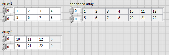

I also have a question. Concatenating 1D arrays works fine
1,2,3,4  concatenated with 5,6,7,8,9 gives 1,2,3,4,5,6,7,8,9
but with 2D arrays
1,2,3,4
5,6,7,8
concatenated with
10,11,12
20,21,22
gives
1,2,3,4
5,6,7,8
10,11,12,0
20,21,22,0
Why not
1,2,3,4,10,11,12
5,6,7,8,20,21,22  ?
Message 5 of 15
(16,283 Views)
Attach your code.
There are several ways to concatenate, maybe you want to transpose first, for example, or wrap a FOR loop around it.
Here's the second method I suggested, same difference: 😄
This seems cleaner, but I am not sure what's more efficient....
Message 9 of 15
(16,237 Views)
