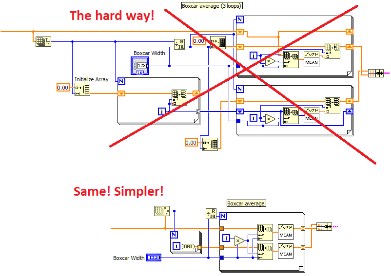

  • Your boxcar averager could be simplified dramatically (image).

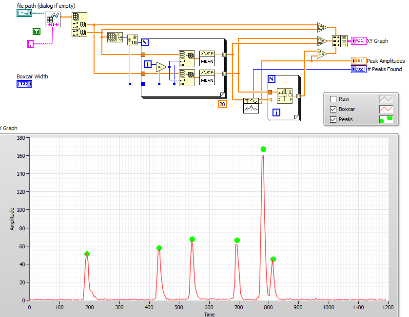

@swilson8 wrote:
I have attempted the peak detection, but it picks up a larger peak twice which I would like to stop by saying that the value has to drop below a certain point so it moves to the next peak.
It seems to pick exactly 6 peaks. looks fine to me. 😄

Sorry for the slow response and the state of the vi. I've been testing lots of things at a time so the vi is rather experimental as I was trying to see what would solve the problem.
The Boolean section was an attempt to create a condition that would mean that only values where dx/dt = 0 and d(^2)x/dt(^2) < 0 would be detected. It kept throwing out an issue where the source was Boolean and the sink was Boolean but it wouldn't accept it for the case structure, I was trying to (but failing) to overcome this.
Your peak detection does appear to give nice values, but it still uses the vi which I am unable to for the purposes of this. This is why I was trying to create this new condition where a peak is detected and then the data must drop below a value before a new peak is then detected.
Thank you

Here's a LabVIEW version of Eli's code, added to altenbach's tidy code for comparison.
