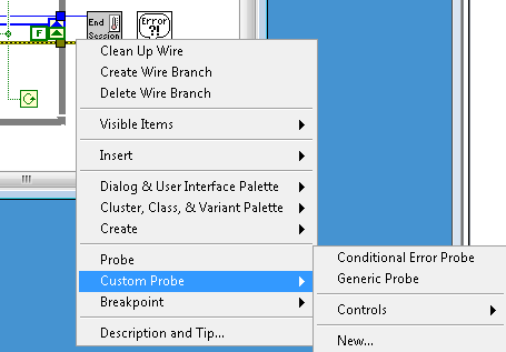

Well, you didn't supply a VI that exhibited this behavior, so I opened one of mine in LabVIEW 2015 SP1 (32-bit) running on a Win 7 SP1 (64-bit) PC.  I right-clicked on an Error line and chose Custom Probes, getting this:
As you can see, Conditional Error Probe is the first item on the list.  No clue what you are doing to not see this.
